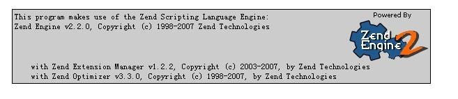

三 检查安装是否成功
写一个phpinfo.php脚本并运行它
phpinfo();
如果你能在输出的Zend部分找到象下面的输出,
那就是成功了。
This program makes use of the Zend scripting language engine:
Zend Engine v1.0.4, Copyright (c) 1998-2000 Zend Technologies
with Zend Optimizer v1.0.0, Copyright (c) 1998-2000, by Zend Technologies
~~~~~~~~~~~~~~~~~~~~~~~~~~~注意看这里
