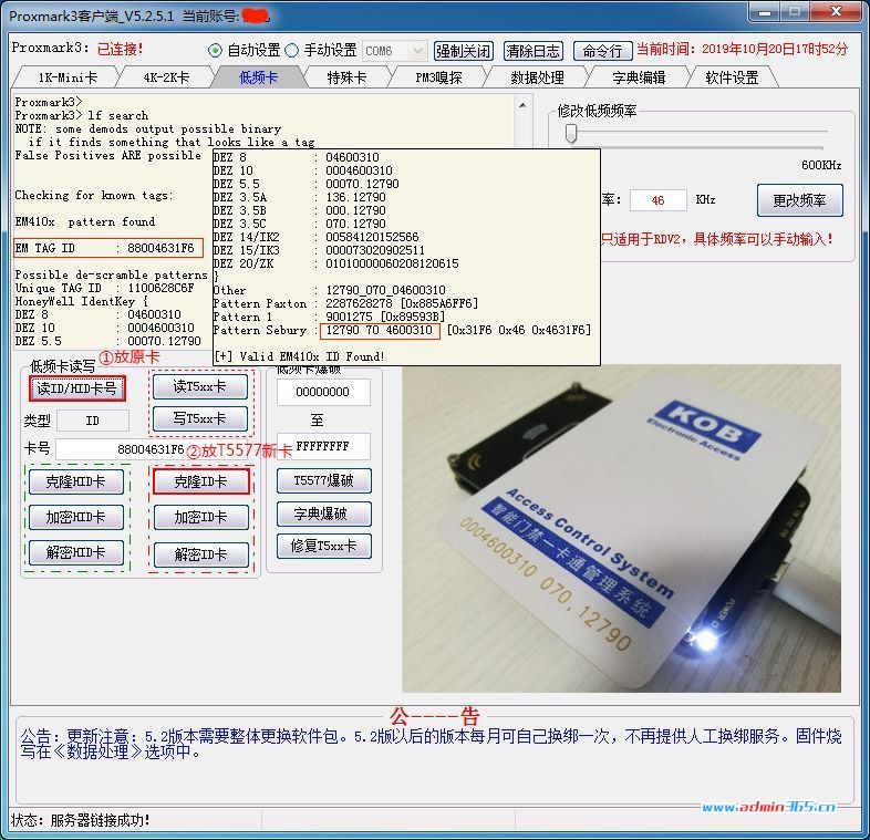

1、将原ID卡放到proxmark3的低频天线上,点击“读ID/HID卡号”。
##读取ID的信息,其中lf是指采用低频工具包
Proxmark3> lf search
NOTE: some demods output possible binary
  if it finds something that looks like a tag
False Positives ARE possible
Checking for known tags:
EM410x pattern found
EM TAG ID      : 88004631F6
Possible de-scramble patterns
Unique TAG ID  : 1100628C6F
HoneyWell IdentKey {
DEZ 8          : 04600310
DEZ 10         : 0004600310
DEZ 5.5        : 00070.12790
DEZ 3.5A       : 136.12790
DEZ 3.5B       : 000.12790
DEZ 3.5C       : 070.12790
DEZ 14/IK2     : 00584120152566
DEZ 15/IK3     : 000073020902511
DEZ 20/ZK      : 01010000060208120615
Other          : 12790_070_04600310
Pattern Paxton : 2287628278 [0x885A6FF6]
Pattern 1      : 9001275 [0x89593B]
Pattern Sebury : 12790 70 4600310  [0x31F6 0x46 0x4631F6]
[+] Valid EM410x ID Found!
Proxmark3>
从回显结果,可以获知卡的类型是EM410x,EM ID是88004631F6。

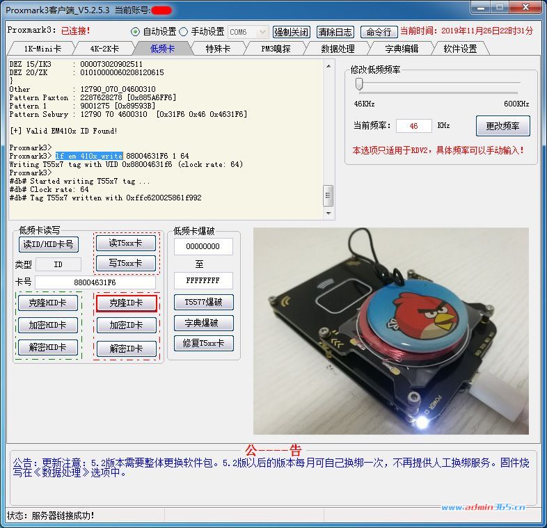

2、接着直接写入新卡,将T5577新卡放到proxmark3的低频天线上,点击“克隆ID卡”。
##   if em 410x_write工具写入,最后1和64是写入的数据块大小
pm3 --> lf em 410x_write 08003C9F5F 1 64
Writing T55x7 tag with UID 0x08003c9f5f (clock rate: 64)
#db# Started writing T55x7 tag ...
#db# Clock rate: 64
#db# Tag T55x7 written with 0xff822001b12f2bd6
